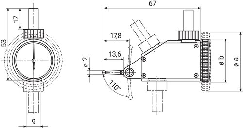

Test indicator MarTest 800 V
Product number: 4302200
DIN 2270
Measuring range : ± 0.4 mm
Readings: 0.01
Package contains: spanner for changing the styli, stylus dia. ø 2 mm, mounting shaft 800a8, test certificate, instruction manual, case

  • Measurement of concentricity, alignment, parallelism and flatness
  • Centering of bores and shafts
  • Parallel or perpendicular alignment of work pieces
  • High-contrast dial face, sealed with O-ring
  • Mineral glass viewing panel for best protection:
    - against cracking, scratching or damage caused by hot shavings
    - optimum resistance to solvents
  • Matt chrome-plated protective casing with three integrated dovetail guide rails
  • Shockproof measuring mechanism
  • Anti-magnetic model
  • Automatic adjustment to the contacting direction ensuring infallible readings
  • Ball bearing mounted double lever
  • Friction clutch overload protection
