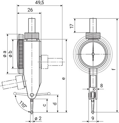

MarTest 800 SA | Art. no. 4301200
b 30 mm | c 13.6 mm | d 17.8 mm | e 75 mm | f 99 mm
