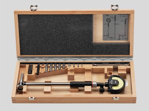

Package contains: measuring holder, measuring head, anvil spindle, wooden case, excludes indicator

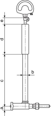

a 16 mm | b 24 mm | c 366 mm | d 110 mm | e 28 mm |
