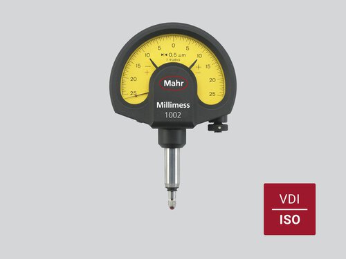

Mechanical dial comparator Millimess 1002
Product number: 4335000KAL
Dial comparator Millimess 1002
Factory standard
Dial color: Yellow
Measuring range : ± 25 µm
Readings (µm): 0.5 µm
Measuring force: 1 N
Package contains: test certificate, case

  • Large, high contrast dial face
  • Adjustable tolerance markers
  • Lockable fine adjustment screw
  • Shockproof movement
  • Mounting shank and measuring spindle are both made of hardened stainless steel
  • Measuring spindle is mounted in a high precision ball guide for minimal hysteresis
  • Resistant to lateral forces (side play) acting on the measuring spindle
  • Maximum sensitivity and accuracy are ensured by the jeweled movement in conjunction with the precision gears and pinions
  • Box type protective housing
  • Constant measuring force
  • Measuring spindle can be retracted with either a screw in cable release or with a lifting knob
Scope of delivery test certificate, case
