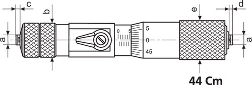

- Rigid, lightweight tubular construction
- Locking device
- Carbide tipped spherical measuring faces
- Interchangeable extension 44 Cv contains cylindrical gage rods that are spring mounted in protective sleeves for the extension of the measuring range
- Protection sleeves have a satin chrome finish

a 5 mm | b 16 mm | c 2 mm | d 2 mm | e 18 mm |
