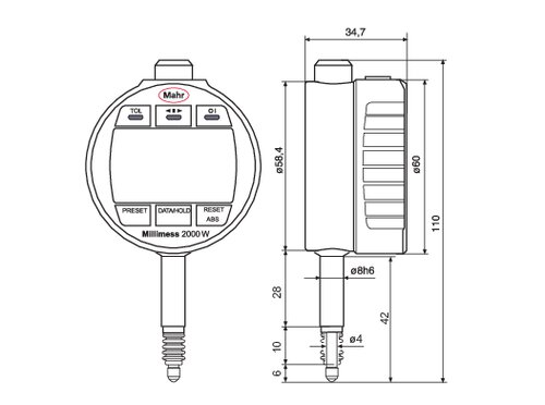

Inductive dial comparator Millimess 2000 Wi
Product number: | 4346701 |
IP protection category: IP 64
Factory standard
Measuring span : ± 1 mm
Resolution: 0.0001, 0.0002, 0.0005, 0.001, 0.002, 0.005, 0.01
Resolution inches: .000005", .00001", .00002", .00005", .0001", .0002", .0005"
Supply voltage: 100-240 V
Package contains: USB data and charging cable type DK-U1, Plug-in power supply (with 4 interchangeable adapters) for USB, rubber bellows, Screwdriver for pre-stroke adjustment (hexagon socket 0.9 mm), test certificate, instruction manual, carton
Factory standard
795,00 €
Functions
ON/OFF, mm/inch, RESET (set display to zero), PRESET (for entering a numerical value), ABS (reference to the electrical zero point), Resolution selectable, TOL (Tolerance and Warning Limits Input), Factor (Multiplier for measuring travel), Reversal of counting direction, HOLD (freeze current measured value), LOCK function (key lock), DATA (data transmission), Bi-directional data interface (for data retrieval - transfer of parameters - remote control - individual function locks via MarCom software)
For static measuring tasks
- improved safety of measurement values in measuring stands, as only a light touch of the key - no keystroke - is required, thus no adjustment or deformation of the measuring device - High contrast LCD display, thus very clear and safe to read
- Clear tolerance symbols and coloured LED signals (red, green, yellow) for measured value classification
- with warning limit input: No Go / Go / Warning Limit
- without warning limit input: No Go / Go / Rework - Operating and display unit (bezel) can be rotated through 280°
- Measuring spindle is mounted in a high precision ball guide for minimal hysteresis
- Linearized inductive absolute measuring system
- Measuring force spring is interchangeable
- Lower stop is adjustable
Energy supply
Integrated rechargeable accumulator (up to 4 weeks) or powered by USB Data Cable
Package contains
