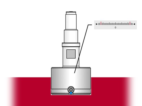

844 DS-M Indicating plug gage
Nominal size: >9-12
Measuring span : 0.6
Connection thread g: M6x0,75
Design: For blind holes, with extended measuring range
621,00 €
Variants
5,60 €
Please enter the label
Application Model for blind holes, with extended measuring range
Recommendation:
To protect the measuring contacts, when inserting them into the bore, the use of a holder with lifting device (844 Kga or 844 Dga) is recommended.
  • For measurements close to the base of the hole
  • For the rapid testing of diameter, roundness and conicity of bores
  • Especially suitable for testing batches with wide tolerance zones
  • Rocking in the bore is not required to determine diameter
  • Ideal for use in conjunction with digital display units and for subsequent processing of measured values
  • Measuring probe made of hardened, stainless guide cylinder and carbide-tipped probes
  • Carbide driving needle transfers radial measuring movement to the display unit
  • Constant measuring force thanks to inbuilt measuring force spring. Measuring results are therefore independent of personal sense of touch
  • Measuring head, measuring instrument holder, depth extensions, right-angle attachments, and depth stops form a comprehensive modular system
  • To protect the measuring contacts during entry into the hole the use of a holder with lifter (844 Kga or 844 Dga) is recommended
