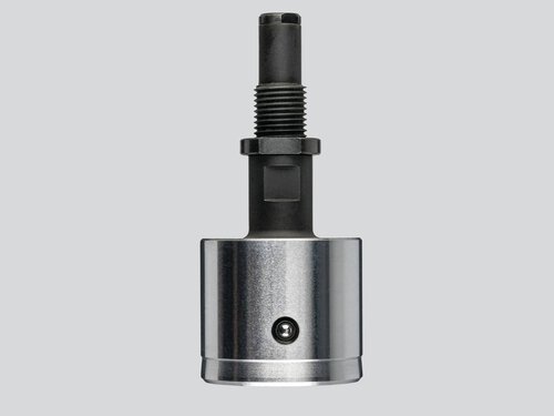

Indicating plug gage Marameter 844 DR
Product number: | 4484039 |
844 DR Indicating plug gage

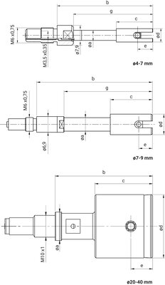

Marameter 844 DR | Art. no. 4484039
a 4 mm | b 38 mm | c 14.5 mm | e 6 mm | g 31.5 mm |
