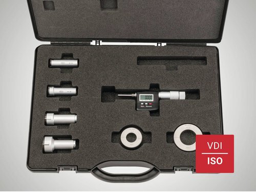

Digital inside micrometer in set Micromar 44 EWR
Product number: | 4191163KAL |
IP protection category: IP 52
Data interface: Digimatic, Opto RS-232C, USB
DIN 863-4
Measuring range 50 - 100 mm mm
Package contains: basic units 44 EWg, measuring heads 44 Ak, setting rings, battery, instruction manual, case
- Through holes
- Blind holes
- Centering shoulders
DIN 863-4
3.626,00 €
Functions
RESET (set display to zero), ABS (display can be set to zero without losing reference to preset), PRESET (for entering a numerical value), mm/inch, LOCK function (key lock), DATA (data transmission via connection cable)
- Through holes
- Blind holes
- Threaded connection for changing the measuring head
- Self-centering measuring head consists of 3 anvils (offset 3 x 120°)
- Measuring anvils from 12 mm are carbide tipped
- From 12 mm measuring anvils for measurements up to the bottom of the bore
- From 40 mm measuring head housing made of anodized aluminium
Energy supply
Battery life approx. 2 years
Data interface
Scope of delivery
