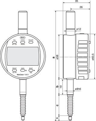

Functions ON/OFF, RESET (set display to zero), mm/inch, Reversal of counting direction, PRESET (for entering a numerical value), TOL (enter tolerance limit values), <0> (Icon mode of the tolerance display), ABS (display can be set to zero without losing reference to preset), DATA (data transmission), Factor (Multiplier for measuring travel), LOCK (individual key lock)
Application Comprehensive measuring function for static measurements such as lengths, distances and length differences
  • Integrated wireless transmitter
  • High contrast LCD
  • Operating and display unit (bezel) can be rotated through 280°
  • Mounting shank and measuring spindle are both made of hardened stainless steel
  • Immediate measurements due to the Reference System
Energy supply Battery life approx. 3 years (approx. 0.5 in wireless mode)
